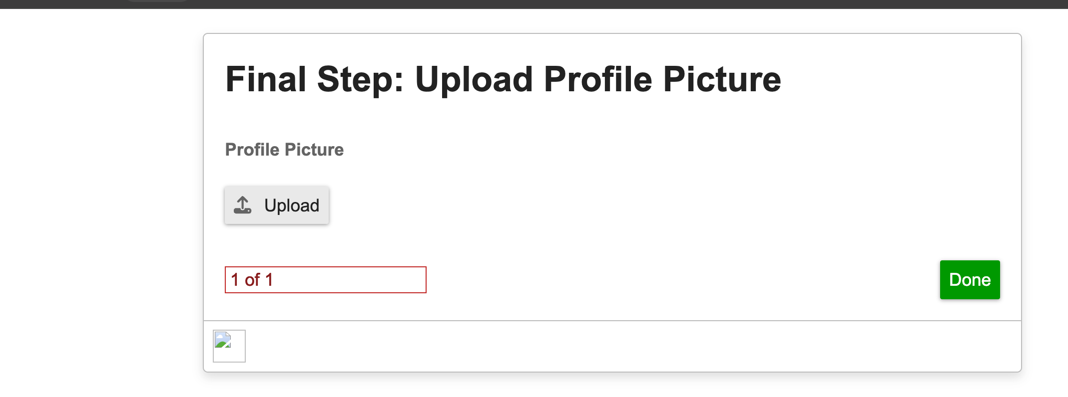

Amazing, thank you! i got it to work. Two additional questions.
do you know what’s with the missing image at the bottom. how to remove it?
is it possible to prompt this wizard to existing users? i want them to be prompted so they can upload avatar.
Thanks so much!
@Angus could you assist with this final question. Thank you so much
